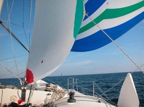

Staysail doing a great job on a Havkat 31 SW

Where this sail does have a role to play is off the wind—and, and its usage in Americas Cups or on modern race boats is the proof. Under spinnaker on certain points of sailing, the staysail helps air flow and moves the centre of propulsion forward and reduces rudder angle and the chance of broaching.
The ideal downwind staysail for racing may not be cut or made in the same material as the upwind sail, but for cruising purposes we can always compromise a little. (However if the boat is equipped with heavy Dacron sails, the dual function of the staysail may justify a lighter high tech staysail which as small may not be very expensive.)
When under spinnaker or gennaker when you decide to try the staysail an important tip is to take one’s time. Check your boat speed for a good few minutes before hoisting. Check your rudder angle if you can. Then hoist and set the staysail, settle down and check the trim, then over another extended period check hull speed and rudder angle. Generalities are often floored but between 90 and 120 degrees apparent, the staysail should pay and make sailing more comfortable. Again try this under good conditions first, smooth seas and moderate winds.
In light airs the staysail often does not twist and the spinnaker does not fly out enough. In this case the staysail will have a negative effect on performance. In heavy weather the staysail if maintained but eased to the limit of backing can avoid broaching under spinnaker or Genoas.
