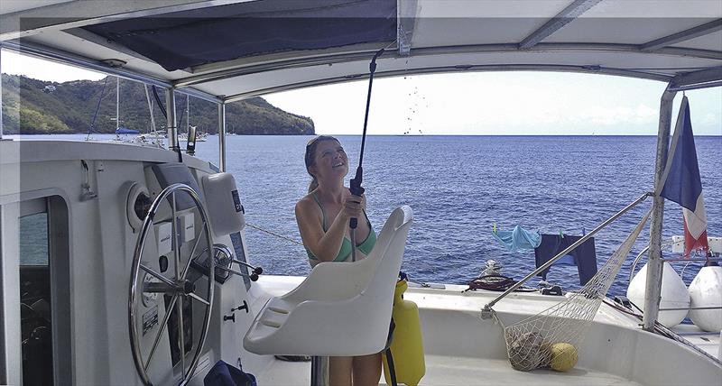

Laura using the spray bottle to clean stainless steel © Mission Océan

Keeping the boat clean, and free of salt and rust is a potential drain on fresh water resources when not in port.
We have overcome this with one simple purchase from a gardening store in Martinique: a crop-spraying gun. When filled with a little fresh water, this enables us to spray our stainless steel, windows etc. with a light mist, then wipe over with a cloth to keep them clean. We also use this for rinsing wetsuits, kayaks, boat hooks... anything that gets salty and needs a quick wipe down. Compared to a hose, or a bucket and sponge, the water usage with our spray gun is a tiny percentage.
