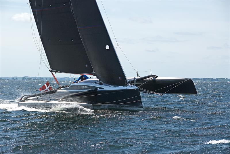

Black Marlin © Jake Kavanagh
The best way to make a cruising yacht with a performance 'far above normal' is to use multiple hulls infused with West System International's PRO-SET epoxy. Then use composites to create an equally light rig and interior. Fit an electric motor for green propulsion and the result is Jan Andersen's awesome Black Marlin.
Boat builder Jan Andersen is the one-man band running Vision Boats, a company that specialises in building fast and eco-friendly sailing yachts in carbon composites. His yard is based in Scandinavia and Jan himself has ranged far and wide to gain the experience needed to create his 'ultimate' yacht. These have included a return trans-Atlantic crossing and a voyage from New Zealand to the Mediterranean. So far he has created two trimarans, with a third currently under construction.
The first was built in cedar and called Barracuda and was the test bed for his next yacht, Black Marlin. Named after the fast and ferocious fish (one of them famously took down a fishing boat off the coast of Florida) Black Marlin is a 10m trimaran with two outer hulls that can fold inwards for road transport and docking. What is so remarkable is that the use of PRO-SET infusion epoxy and carbon fibre has created a 30ft yacht that weighs just 1460kg ready to sail.
There has been no scrimping on accommodation either to achieve this startling performance. The interior is nicely finished with wooden veneers and the main saloon table can seat eight. The hull is so easily driven that it is powered by an electric motor recharged from renewables, so Black Marlin is very much a self-refueling yacht.
"I am interested in using and developing the latest knowledge and materials to create the best products," Jan writes on his website. "My great passion for multi-hulls has made trimarans my speciality."
In addition to building fast sailing machines, Vision Boats also creates carbon masts and booms for other yards using PRO-SET epoxy and female moulds. "The new method we are using gives us a very high-quality spar, with a carbon fibre content of between 65% – 75%," Jan said. "This delivers a top-quality finish, but with low weight and high tensile strength."
Black Marlin has already proved itself with a series of voyages and race wins, including line honours at the Ohavetrundt event in 2016 and winner of the Fyncup in 2017.
Specifications: (racing rig)
  • Type: Modern carbon trimaran
  • LOA: 10.0m
  • LOA (folded): 11.5m
  • Length main hull: 9.6m
  • Beam (deployed): 7.8m
  • Beam (folded): 3.55m
  • Beam main hull: 2.54m
  • Draft (swords down): 2.10m
  • Draft (swords up): 0.4m
  • Airdraft: 16.5m
  • Weight (ready to sail): 1460kg
  • Mainsail: 46m2
  • Foresail: 20m2
  • Gennaker: 85m2
  • CE Category: B
