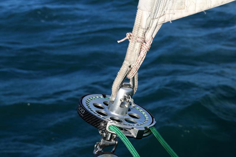

Bottom-up - Tack of sail is lashed to bottom thimble of torsional cable © Facnor Furling Systems

The sail is lashed to the thimbles of the cable at both the tack and head. The cable sits with the sail in the sail bag, already tightly furled. When it comes time to deploy the sail, the cable thimbles are attached to the furling drum at the tack and a swivel at the head, hoisted as a long sausage and tightened. To unfurl, the continuous line drum is allowed to spin freely until the sail is fully deployed. When it comes time to furl away the Code 0, as the furling drum starts to turn, it starts to wrap the bottom of the sail around the cable first and the furl gradually works its way up the luff of the sail - hence the expression "Bottom-up".
