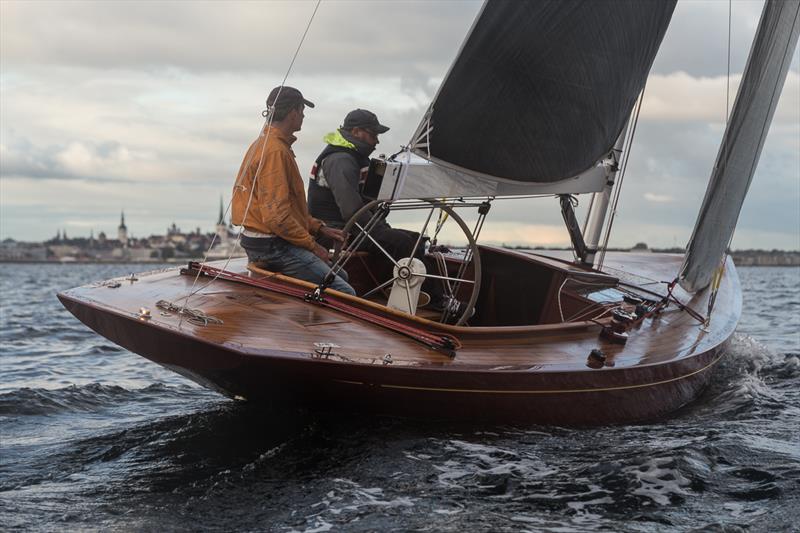

Sailing Swiss Performance Yachts 10m sailing yacht © Kristjan-Jaak Tammsaar
Tucked away within a modern furniture factory near Tallinn, Estonia, a small company is building beautiful new boats in wood whilst also restoring some classics from the 60's. The first 10-metre sailing yacht was being made using WEST SYSTEM® epoxy to bond the mahogany veneers.
Built to plans from the Dutch naval architects Hoek Design, Swiss Performance Yachts first 10-metre sailing yacht is a modern classic. On a visit to Estonia last year, we saw the hull taking shape in a factory workshop just a few yards from where high-class Jacuzzis were being built for penthouse apartments.
The 10-metre yacht has the sleek graceful lines reminiscent of a Folkboat and is really intended as a day-sailer with weekending capability. The hull is made using cold moulding techniques, with yellow cedar planks on the inside and three layers of mahogany veneers built up on the outside.
"Here in Estonia we have the wood-working skills available to create such a beautiful yacht," said CEO Mairold (pronounced 'may-rolled) Metsavir. "We can make one of these boats a year and whilst wooden boatbuilding is not a huge share of the market nowadays, the custom base is made up of dedicated and passionate enthusiasts willing to commission a brand new yacht from us."
However, the 10-metre is not entirely traditional but rather a mix of the best of both worlds. She has a carbon mast, a modern bulb keel arrangement and a 7hp Farymann diesel engine working via a Gori folding propeller, but sit in her traditional cockpit and glance down into her hand crafted hull and you could be stepping back to the glorious days of sail.

Technical specification:
  • Model: Swiss Performance Yachts 10-metre
  • LOA: 10.4m
  • Beam: 2.4m
  • Draft: 1.4m
  • Displacement: 2000kg
  • Construction: Wood epoxy laminate
  • Rig: Fractional sloop
  • Keel: Fin keel with bulb
  • Rudder: Balanced spade design
  • Mainsail: 26.5m2
  • Jib: 20.5m2
  • Gennaker: 70m2
  • Engine: 7hp Farymann diesel
  • Designer: Hoek Design Naval Architects.
