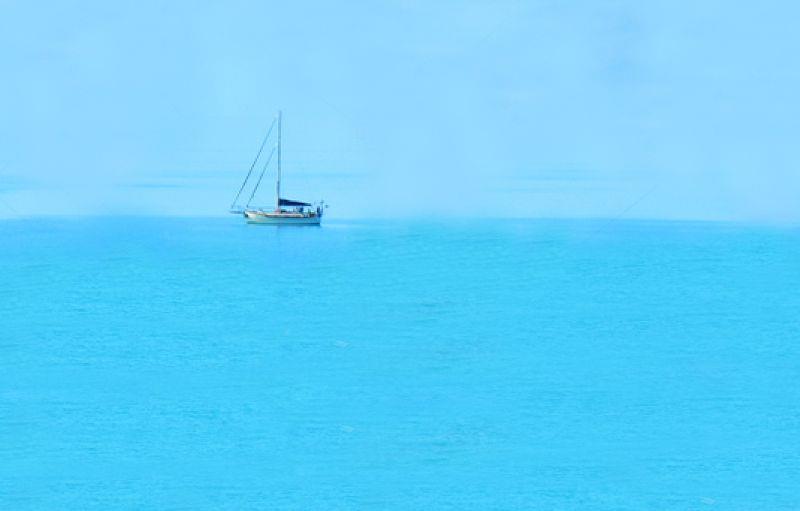

A Cutter Rig © upffront.com
Here at Upffront, we are aware that many people are searching for the perfect bluewater cruising set up. Two popular options for off-shore cruising are the cutter rig and the solent rig, both sporting their own pros and cons.
The cutter rig utilises two headsails that sit relatively far apart from each other: a high-cut yankee connected to the main forestay (high clew to avoid the foot catching in waves when reaching), and a staysail connected to the inner forestay (the lower-clewed staysail catches the wind the high-cut yankee does not). Both sails can be used and tacked at the same time.
The solent stay, on the other hand, sits directly behind the main forestay. It allows the use of two different sized genoas but only one is used at any one time, and the forward genoa needs to be furled during a tack.
