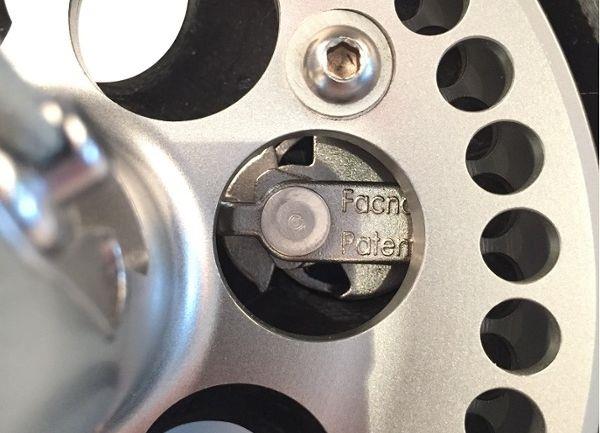

Drum Lock/Ratchet
Continuous furling line systems, with a torsional cable, are not designed to be used partially furled. However, there is nothing more frustrating than losing the grip on the furling line 70% of the way through a furl and the whole thing unspinning in a flash! It is for this reason that ratchets, or drum locks, are an increasingly popular accessory.
Some manufacturers provide a removable drum lock as standard whereas others require a modified drum, so it is something that needs to be considered at the outset.
