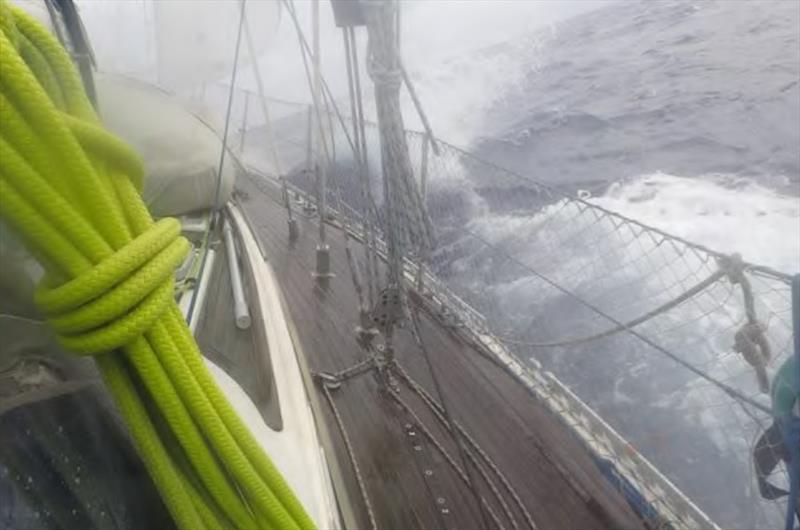

Squalls on the way to Tuvalu two years ago (Victoria photo) © Island Cruising NZ
