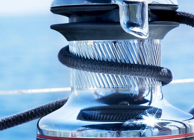

Andersen: They have two ranges, the Black Trim and Full Stainless-Steel, with not much to choose between them. All their winches are self-tailing with stainless-steel drums which reflects their cruising focus with an emphasis on durability and kindness to ropes. The Power Rib Drum offers exceptional grip for larger diameter, softer sheets. Offered in polished stainless-steel as standard, there is the option for custom Titanium coatings so you can choose the colour that matches your boat!
Harken: There is an extensive range of winches available from Harken. Material options include chrome, aluminium, bronze and carbon fibre. The chrome, aluminium, and bronze ranges all come with self-tailing or plain-top options. Another key distinction within all their ranges is the drum grip:
  • Sandblasted provides excellent grip but can be aggressive on ropes. They are specifically designed for high strength, performance lines and also work well with small diameters.
  • Radial Grip on radial drums is derived from ribs on the surface of the drum. Harken angle these ribs to drive the rope down the drum during easing, to help prevent riding turns. Ribbed drums cause less rope abrasion.
The aluminium Performa range combines sandblasting and radial grip which offers racers and cruisers alike a high performance winch. At the top of the range, their carbon fibre winches are lightweight, durable, and perfect for Grand Prix sailors. They are available with self-tailing, plain tops and top-cleating.
