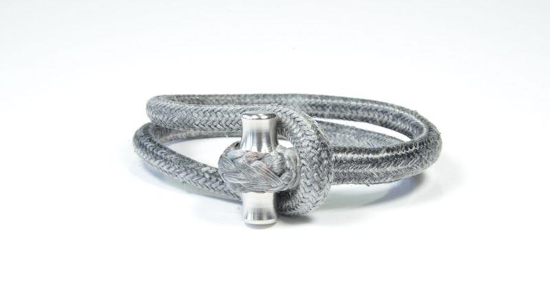

A dogbone is a small, lightweight, dual tapered rod, which can simply and efficiently connect two lines together © Loop Products
What is a Dogbone?
A dogbone is a small, lightweight, dual tapered rod, which can simply and efficiently connect two lines together. As the name suggests, its shape is comparable to that of a 'dog bone', where the middle section is tapered, and the two ends are proportionally wider.

The dogbone is a very flexible connection device and can be used in conjunction with a soft loop/strop to replace almost any shackle. For example:
- Main halyard - to maximise sail height
- Outhaul attachments
- Tack lines
- Spinnaker sheets
- Soft block attachment
