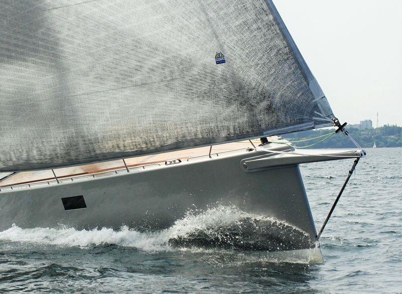

Caro, built by Knierim Yachtbau, during sea trials in Kiel © Meike Brunssen / Knierim Yachtbau
