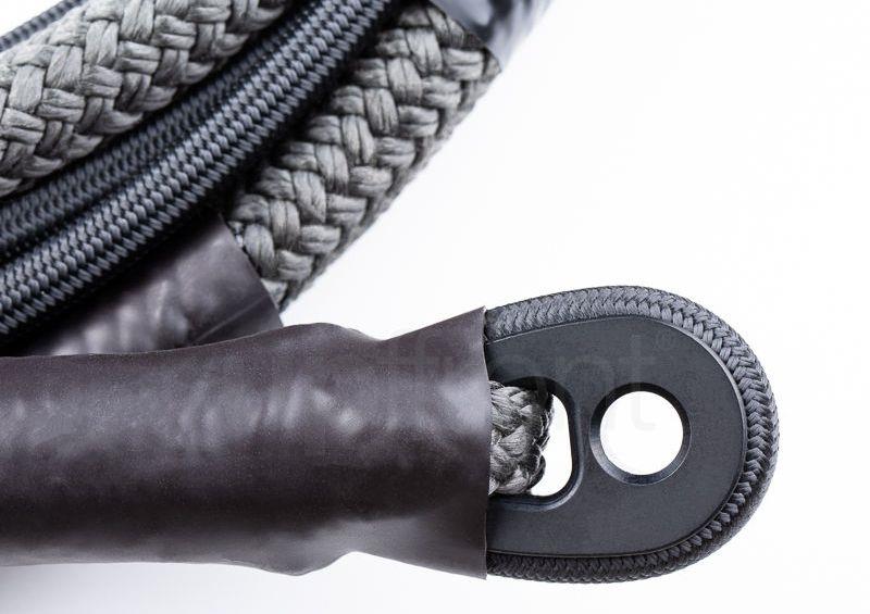

S-Splice termination in torsional rope © Kohlhoff Rigging

To produce a finished torsional rope, the cable is cut from a roll and needs to be terminated, at the required custom length, around a thimble at each end (to fit your furling unit/swivel). Due to the nature of the rope, it is impossible to splice and the ends of rope are commonly secured with a metal clamp.
However, using a metal clamp as the termination method has disadvantages. Heavy and bulky, it is possible the cumbersome clamp could catch your sail or possibly even tear it in addition to being a real snag hazard for sheets and lines. What's more, in our view the use of metal clamps, on a high-performance composite material, is archaic and doesn't align with upffront.com's continued passion for lighter, faster, and safer sailing.
One of our preferred suppliers, Kohlhoff Rigging, are making waves in torsional rope innovation, inventing a truly unique, modern, soft solution that has been well received and endorsed by industry professionals across Germany and Northern Europe.
Instead of a clamp, their progressive 'S-Splice' termination makes use of the simple, but highly effective, 'Chinese finger trap' principle.
Similar to the premise behind the Cousin Trestec Constrictor, the braided textile sock constricts, utilising friction, to keep the ends of the torsional rope in place around the thimbles. In addition to the textile sock, the cable's Polyester and Dyneema covers are also glued with a special PU adhesive, ensuring maximum stability and durability.
Further, the ends of the torsional rope, bound by the textile sock, are tapered thus creating a streamlined transition with no hard edges (unlike a cable with a metal clamp). Consequently, the cable is less likely to get caught on sailcloth, lines or sheets - plus the tapered edge can easily go inside the sail luff pocket.
Benefits of this 'braided sock' termination method, in comparison to a metal clamps, include: lower profile, lightweight, flexible and soft thus meaning it is kinder on the sails.
On top of all this, the standard thimble used by Kohlhoff Rigging is a Loop Product, purpose-built for this technique. This thimble has an additional hole which the braided cover travels through, meaning it is impossible for the thimble to twist out of the eye in the torsional rope, which can be an issue with other methods.
The Kohlhoff Rigging S-Splice has been fully load-tested and exhibits excellent grip (due to the braiding angle of the cable jacket which is optimised for grip and anti-twist), good breaking strength and the special aramid cover prevents slipping of the splice and ensures optimum torque transmission.
