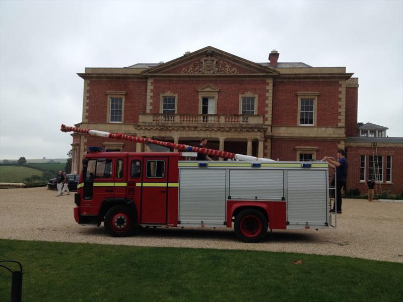

The Wooden Flagpole Company delivers with a decommissioned vehicle from the Carlisle Fire Service © Wessex Resins & Adhesives
If you were to see a fire engine drive past with a flagpole strapped to the roof you would be forgiven for being confused. Although an unusual choice for a company vehicle, the decommissioned appliance from the Carlisle Fire Service is ideal for the Wooden Flagpole Company to deliver and install its traditional wooden flagpoles.
