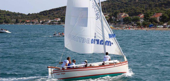

Croatian Gajeta build - a sneak peek at the finished article © Wessex Resins & Adhesives
A gajeta is a traditional design of small open fishing boat but as they are raced competitively, an enterprising naval architect decided to make one using modern epoxy techniques. In this instalment, the computer-generated design is taking shape on its temporary jig and the base layer of planks has been glued into place. Now the team at the Betina Shipyard in Croatia can start to lay the thin layers of mahogany over the top before sheathing with WEST SYSTEM epoxy.
