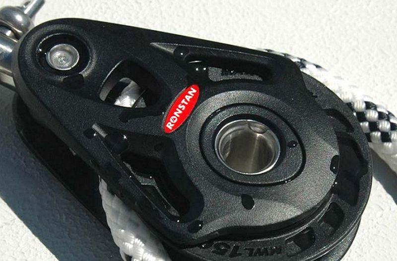

Ronstan invested significant time and effort in developing the Core Block range for keelboat sailors © Ronstan
Ronstan invested significant time and effort in developing this functional and stylish range, for keelboat sailors.
