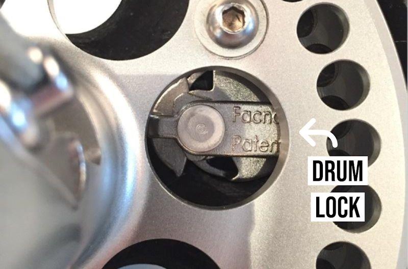

Furling Drum Locks © Facnor
There is somewhat of a debate over the use of drum locks on a continuous line furling drum. As it says on the tin, a drum lock is designed to lock a continuous line furling drum in place, in order to prevent accidental unfurling which can be inconvenient and potentially dangerous.

However, all the above are solutions for securing a fully furled code zero or asymmetric. The role of a drum lock is quite different - it is designed as a temporary safety mechanism to prevent an accidental unfurl during a manoeuvre.
Imagine the scenario: you are half way through furling in the code zero and you spot your favourite, double grip, winch handle on the opposite side deck, just about to plop overboard. What do you do? Drop the furling line and let the sail unfurl, risking expensive sail damage... or save the sail and lose the handle!?
This is where the automatic drum lock comes into its own, allowing you to save both the sail and the handle! You can literally 'drop' the furling line and the lock will automatically engage, holding the drum whilst you grab the handle. Then you can come back to the furling line and quickly resume the furl.
When using a furling drum lock, it is important to remember that they are only intended as a very short-term safety device, not a secure way of holding the drum for long periods. They should also never be used as a reefing system the lock mechanisms are not designed to take this type of load.
It sounds like a sensible feature why wouldn't I have one?
The downside of the drum lock is that they add a layer of complexity to an otherwise very simple system. Some drum locks only work in one direction which means you always have to be conscious of the direction of furl. Plus there is the additional reliability risk and the possibility that a faulty drum lock actually prevents you from completing a furl.
Ultimately, for cruising and shorthand sailing, upffront.com would definitely recommend a drum lock as a valuable temporary safety mechanism, and a great addition to your furling system for increased peace of mind.
However, for racers and fully crewed boats we would suggest a drum lock is not needed in fact, a lot of racers remove it, as the potential downsides outweigh the benefits.
