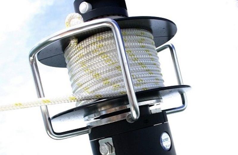

The LS range is Facnor's baseline traditional genoa furling system, for boats 5.5m to 28m in length. Designed as a cruising model, it is composed of a classic drum, a series of sections (that sit around the forestay) and a halyard swivel hoisting system. The foil sections are round with twin grooves and offer reliable, steady furling alongside high rigidity - furling is easy, even under halyard tension.
The Facnor LS range boasts the following features:
  • Strong, resistant sections & connections (with high torque resistance)
  • Rugged parts - 30µ Anodized Aluminium protects against impact and abrasion
  • 360 degrees furling line lead angle
  • Optional internal turnbuckle fitting
  • High load, waterproof halyard swivel
  • No-maintenance bearings
In addition, the LS furling system is easy to install: due to the patented telescopic sections, the system can be installed without unstepping the mast or cutting the wire. On top of this, the bearings which run in grease - require no maintenance: the 'bearing box' utilises self-lubricating polymer fibre bearings.
The LX furling range builds on the LS range, offering a cruising specification adapted for ocean navigation.
The fixed tack fitting is upgraded to a rotating tack fitting; using Torlon ball technology, the tack fitting allows free and smoother rotation which, in turn, allows the furler to automatically take up the sail fullness when furling, providing a better sail shape. The LX feeder is stainless steel and the classic drum is replaced by a removable drum, which facilitates a swift change to a twin groove headfoil - ready for racing.
The RX range is a version of the LX which has been adapted for racing. Like its counterpart, the RX features a removable drum, rotating tack fitting and stainless steel feeder. However, the major difference is the foil sections: the RX employs elliptical sections instead of rounded, which are smaller and more aerodynamic.
