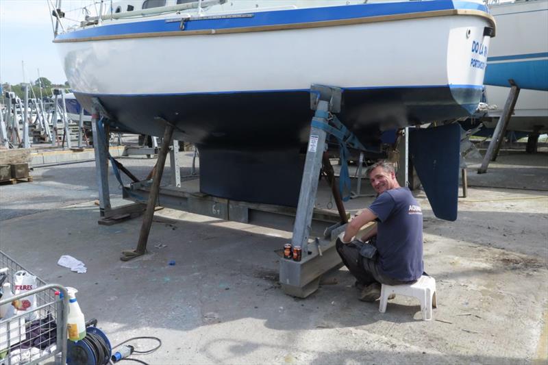

Mark at Aquamarine Ltd works on all types of boat projects, from budget weekenders to superyachts © Wessex Resins & Adhesives
Here's a tip for preparing a teak plank for a small-scale project such as a cockpit table. It could work just as well on a complete deck. Mark at Aquamarine Ltd uses it whenever he wants to bond teak to a substrate rather than physically attach it with screws.
Mark uses WEST SYSTEM® Epoxy widely. He works on all types of boat projects, from budget weekenders (pictured) to superyachts. He is based on the UK's central South Coast.
