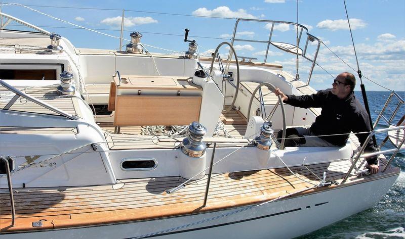

Andersen Winches on an Xc42 © Klaus Andrews
Andersen Winches are a big name in the boating business. Designed and manufactured in Denmark, Andersen Winches have earnt a reputation for building first class, high quality winches.
The stainless steel winches are known for being durable and reliable, and with their smooth, Power Rib drum they provide excellent holding whilst remaining kind to your ropes.
