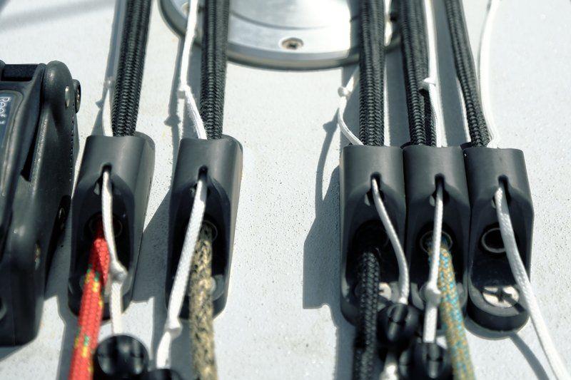

Clutches:
A rope clutch uses a toothed cam which is controlled by a handle. When the handle is down, the cam is engaged and the toothed plate keeps the rope in place. To fully release the line, simply open the clutch handle.
Clutches are ideal for controlling medium loads, and are therefore used extensively on medium sized boats. As a rule of thumb, choose a rope clutch when you would use a cleat, but the load is higher; with a clutch, it is possible to lock off a halyard, main, jib or even spinnaker.
Like a cleat, a rope clutch allows easy trimming and adjustment (lines can be pulled in with the clutch closed) and, in an emergency, a fully loaded line can be quickly released without the need for a winch. Having said that, in most situations it is better to take the loaded line onto a winch as a precaution, before releasing the clutch and also to minimize wear and tear.
As a clutch is more complex than a cleat, there are more moving parts - and so more maintenance is required. Explore our guide on the Spinlock rope clutch range.
When to Choose a Clutch:
  • For lines that are regularly adjusted
  • For lines on medium boats - e.g. halyards
  • For medium loads
Jammers:
Finally, a jammer works in much the same way as a clutch, but the handle cannot be released whilst under heavy load.
Instead, the load in the line must first be taken to a winch and tensioned so all the load is now off the jammer, and only then can the handle of the jammer be pulled out and the rope released.
As a result, no adjustment is possible, making jammers a good option for permanently loaded lines such as halyards on larger boats.
Arguably slightly more work than a clutch, a jammer is a good choice when the load is high and you need a completely strong, secure and reliable option - sometimes a jammer is the only option that can accommodate high loads on larger boats!
Although there are some safety implications of not being able to quickly release the line, there are relatively few moving parts which results in lesser maintenance of the jammer.
When to Choose a Jammer:
  • For lines that are permanently loaded for extended periods of time
  • For lines on bigger boats - e.g. halyards
  • For high loads
