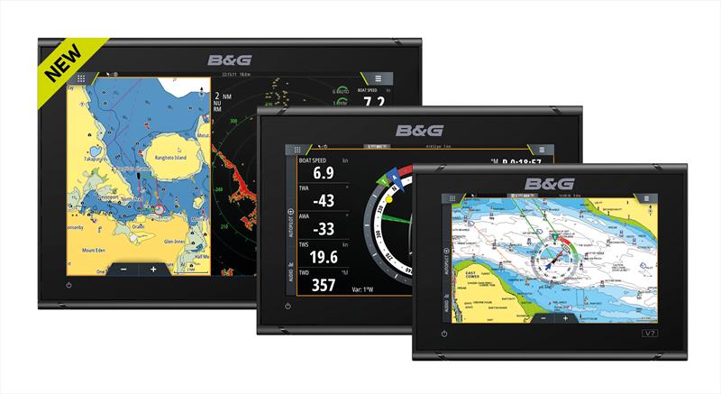

B&G Vulcan Series © B&G

B&G's RacePanel software, included as standard on Zeus and Vulcan chartplotters provides a highly accurate, high-resolution starting aid that can help you be on the line as the gun fires. As well as getting the perfect start there are also waiting areas and exclusion zones to comply with, luckily B&G have created a downloadable GPX file to display the pre-start waiting areas and the exclusion zone off Seaview in bright red, overlaid on the chart, so you'll have no excuse.
