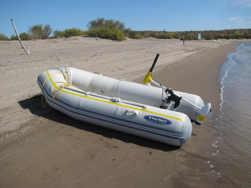

We bought 'Stealth', our MinnKota 55/S electric outboard in May 2011, and used it with our inflatable tender while cruising around Vancouver Island and the Gulf Islands. It accompanied us to Mexico in 2015, where we use it for snorkeling, bird-watching, mangrove-exploring, and general transportation.
Stealth has held up fine over the past eight years. It still runs smoothly in forward and reverse, and the moving parts (tilt, steering, propeller depth, transom clamps, and handle extension) haven't broken and function well. There are no signs of corrosion, though the white paint on the lower drive unit has blistered and is flaking off the cast aluminum housing. However, this is just a cosmetic problem. On the cosmetic topic, two years ago we spray-painted portions of the engine with a yellow acrylic; this was done purely for identification and as a theft-deterrent measure. We don't know if that was necessary, but our engine hasn't gone missing yet.
We'll just make a short statement about maintenance costs for our electric engine since 2011: none. No tune-ups, no spark-plug changes, no oil and filter replacement... nothing. We merely rinse off the motor with fresh water a few times per year before storage, and we've spread a bit of Lanocote (lubricant and corrosion preventer) on the threads of the transom screws. We initially had doubts about the durability of the plastic propeller, but so far it has held up fine, despite running it into sand and even some gravel a few times. The edges are slightly dulled, but it still pushes us around with minimal vibration.
