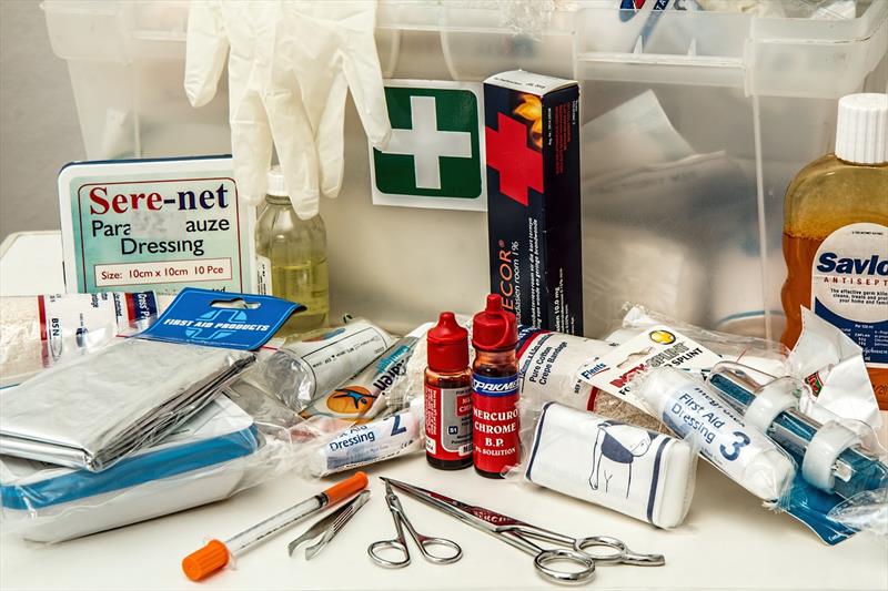

First Aid Kit(s) for Cruising © Steve Buissinne

First, we looked for organizations that had worked systematically to solve this set of problems so we could emulate their methods and techniques. The military immediately came to mind, as they have applied science and rigour to responding to emergency medical situations in rustic locations (although they admittedly seem to focus on gunshot wounds and extreme blunt force trauma as the primary sources of injury). We also read up on mountaineering and other wilderness response experiences, and found the 'prepper' community had many guidelines, tips and resources that seemed useful. The Ministry of Transport in the UK also had relevant resources. While many sources suggested that buying supplies separately would be cheaper than buying a kit, we found the reverse to be true, and that the kits we looked at offered value as well as convenience.
So after our obsessive research, we equipped ourselves with a simple 'boo-boo kit' for day to day stuff.
This is the type of kit you see in a larger drug store, Costco, Walmart, or some other big box store. You can buy them online at Canadian Safety Supplies. They are also available from the Red Cross, St Johns Ambulance or similar organizations online. It's portable, so we don't have to drip blood on the way to the bandaids; soft sided so it's easy to store, and reasonably comprehensive for small injuries. It unzips and flops open to display the contents when in use. There is plenty of room in the carry bag to augment the contents.
