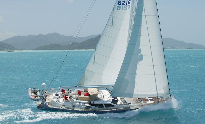

Dacron Coastal Cruising Sail with vertical battens for in-mast furling © Doyle O'leu

The in-boom option requires less compromise of your ideal sail shape, but it does require the angle of the boom to be precisely located before you start furling away the mainsail. Otherwise the furl will not go smoothly. Despite the challenges, as a sailmaker, Lorenzen tends to be more of a fan of in-boom compared with in-mast. "The sails for the in-mast option are very different. You can do a charter boat with negative roach which is quite ugly - but it's still sailing. You need vertical battens, it doesn't matter whether they are long or short battens, but they tend to be longer than normal horizontal battens. I can't say it's an elegant solution, but it works."
In-mast mainsails are very easy to stow away under most circumstances, which is what makes them so attractive for charter use. However, they're much harder to raise and lower in the first place, which tends to make this a once-a-season exercise. Lorenzen weighs up the pros and cons. "The shape is not as bad as people might believe. With vertical battens we can create a good roach, so the flying shape is not as disadvantaged as you might think. However, the mast is very stiff and you can't bend it much, so you don't have that last bit of control over sail shape like you might on other boats.
"The problems come, though, if you want to reef the sail or if it is damaged, because there is no way of lowering the sail easily with an in-mast system. The luff of the lowered sail is not attached to the mast, so the sail can easily get blown away during the take-down. The lowering of a reefed sail, which is already furled a few rounds, is impossible without the risk of damage."
