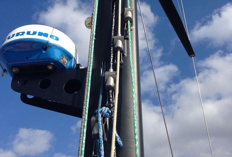

Karver KJ jammers in use © Karver

Full Remote operation - Both the locking and unlocking mechanisms are in-line with the load on the rope and can be operated remotely by trip lines. This has some significant advantages and allow the position of the jammer to be optimized to reduce compression loads. For example, they are often used for tack lines on asymmetric spinnakers where they are mounted on the bow and operated from the cockpit.
They are also great for reefing lines and can be mounted inside the boom which removes the need for highly loaded lines back to the cockpit. This in-line operating mechanism also means the jammer can be mounted in small, inaccessible spaces.
Simple separation of body and base - Due to its clever design, the body is held to its base by only a single screw and can be separated from the base in less than 30 seconds making regular maintenance quick and easy. It also means the base is easy to mount securely, in difficult to reach locations on the mast, boom or deck, without the body in place.
