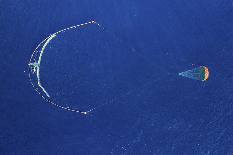

The Ocean Cleanup, the Dutch non-profit organization developing advanced technologies to rid the oceans of plastic, announces today that its latest ocean cleanup prototype system - System 001/B - is successfully capturing and collecting plastic debris.
After one year of testing, the organization's engineers have succeeded in developing a self-contained system in the Great Pacific Garbage Patch that is using the natural forces of the ocean to passively catch and concentrate plastic, thereby confirming the most important principle behind the cleanup concept that was first presented by its founder and CEO, Boyan Slat, at a TEDx conference in October 2012.
Launched from Vancouver in June, System 001/B is The Ocean Cleanup's second attempt to prove its concept of collecting garbage from the Great Pacific Garbage Patch, the largest accumulation zone of plastic in the world's oceans. In addition to collecting plainly visible pieces of plastic debris, as well as much larger ghost nets associated with commercial fishing, the latest system has also successfully captured microplastics as small as 1mm - a feat the team was pleasantly surprised to achieve.
"After beginning this journey seven years ago, this first year of testing in the unforgivable environment of the high seas strongly indicates that our vision is attainable and that the beginning of our mission to rid the ocean of plastic garbage, which has accumulated for decades, is within our sights," said Boyan Slat. "Our team has remained steadfast in its determination to solve immense technical challenges to arrive at this point. Though we still have much more work to do, I am eternally grateful for the team's commitment and dedication to the mission and look forward to continuing to the next phase of development."
New Design Leads to Improved Performance
The aim of System 001/B was to trial modifications, which addressed known complications, primarily aimed at correcting the inconsistent speed difference between the system and the plastic. Consistency was achieved by slowing down the system with a parachute sea anchor, allowing for faster-moving plastic debris to float into the system. Once this main challenge was resolved, prominent plastic overtopping was observed - becoming the next technical challenge to solve. Due to the modularity of System 001/B, a modification to increase the size of the cork line was designed and implemented while the system was offshore. With the new cork line, minimal overtopping is now being observed, thus allowing the system to capture and concentrate plastic.
