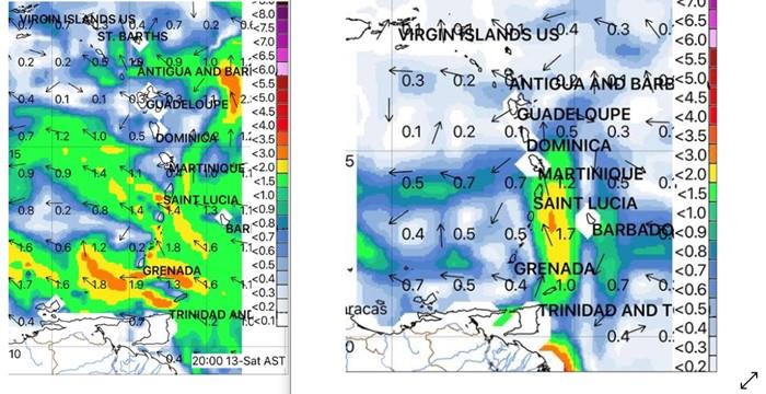

After we got anchored and sails put away, I downloaded a GRIB file for the currents using the Weathertrack app. It then became clear as to why we had enjoyed such a fast passage….a strand of the Antilles current had shifted substantially Eastwards and was now running in a northerly direction up the East side of the island chain straight up to Martinique and we were lucky enough to have hitched a ride along the edge of it. I’m glad we weren’t going in the other direction as it would have been a tough slog fighting that current all the way.
For a visual illustration of what we encountered, look at the screen grabs from the Weathertrack application below. The ‘normal’ location of the Antilles Current is seen in the first screen grab, with the strongest current located between Grenada and Venezuela where it approaches three knots. The second screen grab illustrates the conditions we encountered where a large North-South current plume developed between St Vincent and Barbados and extended all the way to Martinique. Weather track is a useful and easy to use application. To download ocean current GRIB files, I use the NOAA RTOFS model available in Weathertrack.
