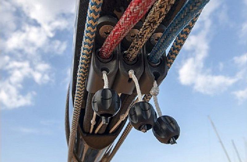

Cousin Trestec Constrictor - A Textile Rope Clutch © Berschi
