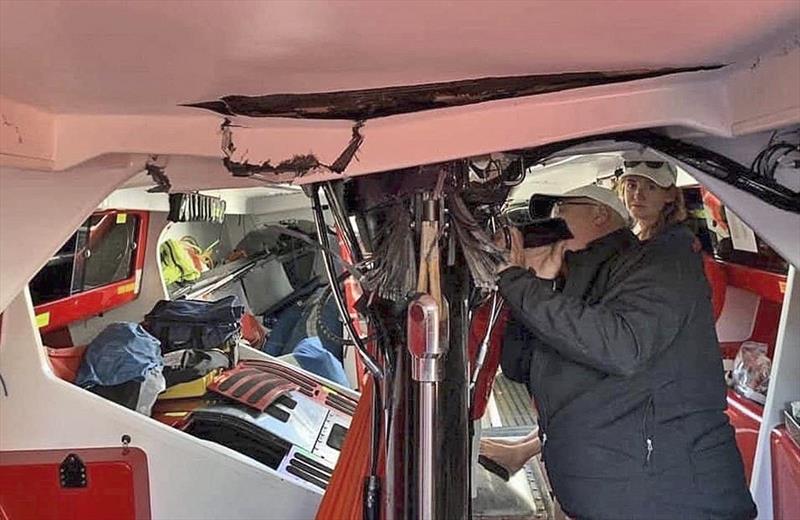

Damage to Wild Oats XI as bottom section of mast fails, and loads up the deck © Voile Dock Talk

Yet it was Wild Oats XI with the greatest calamity, as they nearly blew the rig out of boat. She subsequently pulled into Newcastle. A tremendous amount of seamanship, and a nice dose of luck has allowed them all to walk away unscathed, and with damage that can be repaired, as opposed to fatal.
Now the team have an old stick at the dock at Woolwich, but the word is they may try to cut and shut a new section into the bottom where at least 5m compressed and 'went bang', according to those on board. Section failure appears to be the cause.
They were lit up with the R2 hoisted when it twisted, and it has cracked the deck as well. 'Miracle we do not loose rig' was another statement from on board.
The incident happened at 2030hrs Friday night, off the coast of about Terrigal (pretty place BTW). Iain Murray commented once back in Sydney, "We got off as lightly as we could really. These boats carry enormous loads, so when you get a failure in that sort of situation, everything goes out of alignment. The deck was asked to carry a load not normally requested of it."
"The boat's all packed up, the mast is down and on the deck, and she'll motor back to Woolwich, where the process will start. We will repair the mast we have, and McConaghy's will rebuild the deck and other affected areas. Thankfully there as no major sail damage, and we had our old mainsail on. So yes, we got off remarkably lightly, compared to what could have been", said Murray reflecting on keeping the rig up, not over side, creating holes in the boat and so forth.
There was over 30 knots of breeze at the time, and they did see 40 on approach to Newcastle, which they elected to head to, as it was downhill. "We had 32 knots of boat speed when it happened, reaching away with headsails. We had a kite up for the start, but there was too much West in it once outside, so we went to the double headsail sail plan to be able to hold course."
"We had to keep it on port, as the rig was hanging out to leeward, so even with three reefs we were still doing 15 knots. Certainly the experience of the crew to deal with it really well shone through. Everyone did their job, got the sails down pronto, and so the fact that we saved the rig is remarkable. Dealing with the situation swiftly and accurately has left us with a small problem, not a huge one."
"Honestly, we are lucky it happened in this race, to expose the problem, as we have time to sort it out. The good news is that Wild Oats Xi was going like a scolded cat before it happened." That of course is pretty important when you are chasing your tenth Line Honours victory in the impending Sydney Hobart race. Murray added, "This latest round of upgrades is working (return of the for'ard canard and extra weight out of the boat as well). We have seen this movie before. We'll be on the start line and all strong."
Apart from McConaghy going to work on her structural issues, Southern Spars will have to make another, totally bespoke bottom section, and I dare say sleeve, as these parts have been replaced before.
