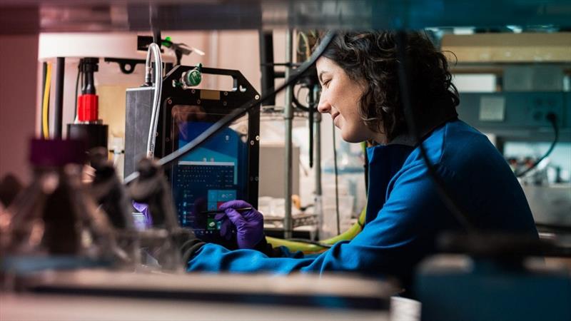

MIT-WHOI Joint Program student Kalina Grabb demos the latest iteration of DISCO in a Watson lab at WHOI © Daniel Hentz, Woods Hole Oceanographic Institution

To overcome these limitations, WHOI engineer Jason Kapit and WHOI scientist Scott Wankel worked closely with Hansel and her lab to develop the world's first portable DIver-operated Submersible Chemiluminescent SensOr, or DISCO. With it, they were able to sample superoxide concentrations in real time during a 2017 research trip to Cuba's pristine reef system, Jardines de la Reina.
The boxy handheld device comprises a water-sealed battery and a tablet screen that scuba divers can operate at depth. Inside, fluidic pumps uptake the invisible chemical as corals produce it. DISCO then adds a chemical to the mixture that reacts with superoxide to create measurable light, read by an onboard sensor. Armed with these tools, DISCO detected notable differences in superoxide levels between species of corals in its first field test.
