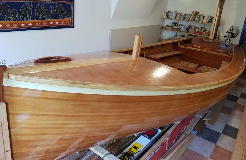

Nevertheless he decided to combine his two passions of wood working and sailing and build a beautiful cedar-planked Stornoway 16. Based near the picturesque harbour of Paignton in Devon, Steve had planned to become an active member of the dinghy cruising association, so wanted a design that would be easy to sail, but roomy enough to camp in overnight. He found his ideal project from the pen of Paul Fisher at selway-fisher.com

Cedar strip method
Although the Stornoway 16 was intended to be built with hard chines, essentially made from wide planks of plywood, Paul Fisher's design also allowed for the cedar strip method.
"The rounded hull shapes that can be made using this technique appealed to me," Steve says. "Paul has added the necessary mould plans and written a book entitled 'Strip Plank Boat Construction.' This has rapidly become my bible."
Thin strips of Western Red or Yellow cedar are machined with a convex curve on one edge, and a matching concave curve on the other. They are then bent around a set of formers and interlock to create the hull.
