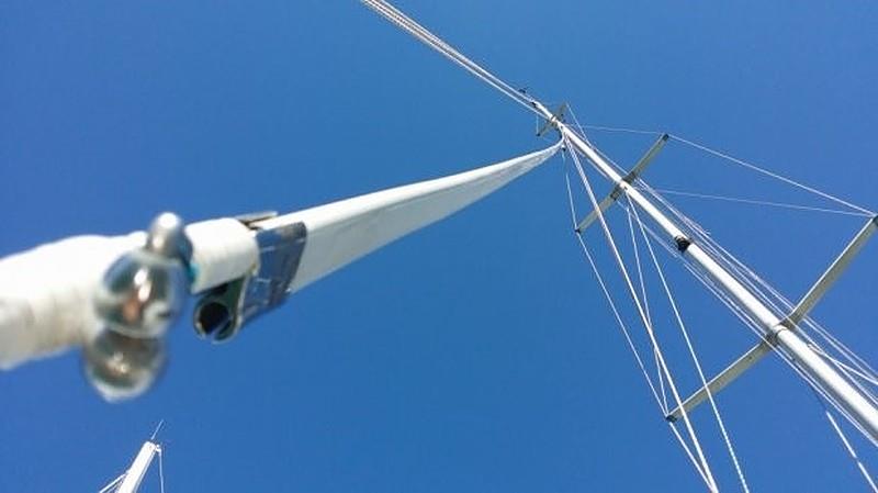

Tuff Luff's twin-grooved headfoil allows for easy and fast headsail changes © Schaefer Marine Inc
Tuff Luff's twin-grooved headfoil allows for easy and fast headsail changes. It is a must-have system for any club or competitive race boat. Tuff Luff is owned by Schaefer Marine Inc. who has been in marine hardware design since 1966.
