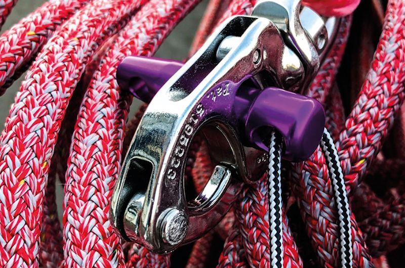

Plug Fids
Plug fids allow for the remote release of trigger shackles. The fid is pushed into the trigger hole and the tapered rear of the fid allows the trigger to snap closed again and hold the fid in place.
A lanyard can then be attached to either of the two holes depending upon the desired location of remote release. For side release, the lanyard is attached to the blunt end and can be pulled out either by hand or by winch. For rear release, the lanyard is attached to the tapered end and pulled from behind.
The fid pries open the trigger and stays captive with the shackle. It can also be used with no lanyard and operated as a 'handle' for convenient release.
Cone Fids
The cone fid does not sit in the trigger and therefore minimizes the chance of accidental release. A lanyard goes through the trigger and sits "in the vicinity" of the shackle until required. There are two types of cone fids: Single and Double cone.
The single cone fids have a recessed area to accommodate a knot at the end of the trip line. When the line is pulled, the fid engages the trigger, releasing the shackle. The single cone is made to be a little bigger in diameter than the trigger hole and will not pass through when the trip cord is pulled. The half cone and trip line stay captive with the shackle once it is released.
The double cone fids come with a retaining screw to lock the trip line in place. The double cone is made to be slightly smaller than the size of the trigger finger hole and will pass completely through the trigger finger hole when pulled. The double cone and trip cord is not captive with the shackle and will come free of the shackle once it is released. In most sailing applications the half cone is more popular.
How to choose between the three?
Choosing between them comes down to personal preference, sailing style and the abilities of your crew and bowman.
The single cone is the most basic, but one of the most popular. It is designed to be pulled at 90 degrees to the load direction of the shackle and remains captive after release. The double cone is more popular for industrial applications where you want the trip line to come free of the shackle once the load is released. The Plug fid offers more flexibility in setup with the option to tie off the other end of the trip line for more control of the fid / trip line, post release. It can also be used at 90 degrees to the loaded shackle, or the trip line run back along the loaded line and tripped from the safety of the cockpit.
