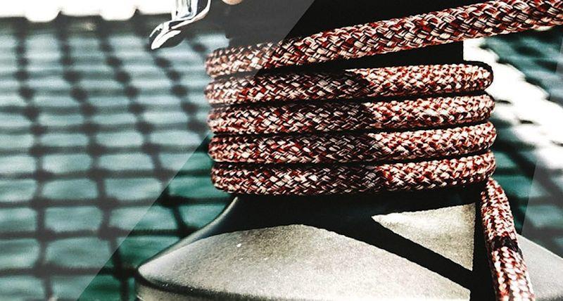

Robline Rope Cruising Ranges Explained © Robline
