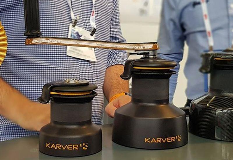

Karver KCW Compact 45 Winch
When you put the KCW Compact 45 winch next to equivalent sized winches in the market it doesn’t take long to work out that Karver has a unique and innovative product.
Karver KCW Compact 45Andersen 40Harken Performa 40
Weight (kg)360049033000
Base Dia. (mm)130152157
Height (mm)143172175
Drum Dia. (mm)847580
Power Ratio 16.058.913.5
Power Ratio 2454039.9
The two-speed KCW 45 is a lightweight, compact unit with a very small footprint. However, it is its gear ratios that make it really stand out from the crowd. In its size range, it has the fastest first gear and then the most powerful second gear, making it a perfect halyard winch for any boat up to approx. 40ft.
The step change between the two gears is pronounced which doesn't necessarily make it a good racing sheet winch. You can see from the Harken Performa gear ratios that they assume the crew can contribute plenty of their own power and speed to bring in the bulk of the sheet by hand before requiring the first speed, with medium power. Then there is a gentle transition to the full power for the final few inches. The cruising-orientated Andersen winch, on the other hand, provides more speed in gear one, assuming the crew will use the winch to bring in the bulk of the flogging sheet. It is then a significant step change to the maximum power which means it will take some time to bring in the last few feet of sheet to achieve full trim.
The KCW Compact Winch is therefore a real cruising winch but in a performance racing package. For any boat under 40ft which either races short-handed or with older crew members, it will beat any of the competition out there for a perfect cruising sheet winch. At the same time its compact size, lightweight and power make it the ideal coachroof halyard winch on any performance race boat.
