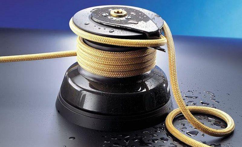

Gotifreddi Maffioli cruising lines explained © Gottifredi Maffioli
