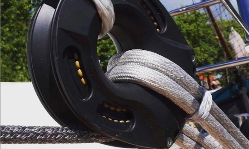

The Orbit Block Range
Finally, the Orbit range represents Ronstan's no compromise, top-of-the-range solution. These blocks are designed for performance sailing and racing for boats from 40 to 100ft.
Key Features and benefits of the Orbit Block
- Efficient design
The Orbit block range has been completely stripped of all parts which do not contribute to load carrying. This reduces the block down to only three parts. The twin side pieces, which are sculpted from a high-grade alloy and a one-piece sheave with captive Torlon® ball bearings.
This gives the Orbit block the highest strength to weight ratio of any Ronstan block and reduces the amount of potential break points.
- Strong bearing system
The Torlon® captive ball bearings eliminate the need for side retainer plates and allow for a wider bearing surface that can accommodate longer needles, improving the strength to weight ratio substantially and ensuring minimal friction loss, especially at high loads.
This advanced bearing technology means that the Orbit range can have up to a 20% higher working load with a 27% lower weight than the Core block range.
- Universal Head
Made from 17-4PH stainless steel, the shackles are extremely high resistance. The head posts on the swivel blocks can be locked at either 0 degrees or 90 degrees. Many of the blocks in the range also feature a removable pin to allow easy attachment.
- Easy to maintain
The cutaway design means that it's very easy to rinse salt and debris out of these blocks with fresh water, helping you to get more out of your blocks.
