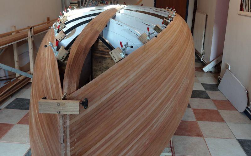

Yellow or Western Red varieties of cedar are the recommended timbers for strip planking, so Steve searched for a local source. He quickly found one at Stone's Marine Timber at East Portlemouth in Devon.
"The quality of timber they supply is exceptional," Steve says. "The Red Cedar I bought was quarter sawn, straight, blemish free and - importantly - in lengths of 5.5metres (18 feet). As the finished boat is only 4.9 metres (16 feet) long, this will save the laborious task of scarfing strips together." Here the timber is being fed into a band saw which can be seen at the far end of the room.
To reduce the 25mm thick x 200mm wide planks down to the required 8.5mm thick and 20mm wide, Steve had to make up a series of feed-in and feed-out tables from scrap wood. He reduced the thickness of the planks with a small Record power planer.
These planks were cut using a table saw. The result was 144 strips of Cedar ready for routing.
Steve then introduced the matching coves and beads into which each plank would slot together.
"Routing the planks is simplicity itself, but there are three important things to remember," Steve advises. "Firstly, it is critical to get the curves exactly centred on the edge of the strip. Secondly, machine the convex curve before the concave one. This is because the concave face leaves feathered edges that are very delicate and easily damaged. Thirdly, to prevent break-out, I noted which way the grain ran. I then cut the strip so that the grain was running out of the timber rather than into it when it reached the cutter."
Because the edges were so fragile, Steve took care to stack each strip as it was cut, rather than simply making a pile to sort later.
"I was amazed how well they fitted together," he says. "If it wasn't for the difference in colour and grain, you would think it was one wide plank, as the photo shows."
