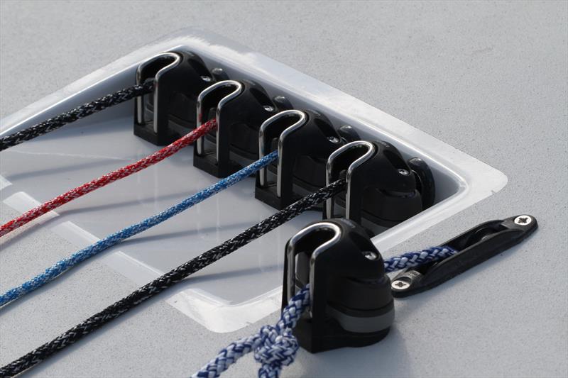

Allen has a range of accessories that suit both versions of the cam cleats. To know which accessory is needed the intended use needs to be clarified. It's also handy to know the difference between the leading and exit side of the cam cleat. The cams open towards the exit side.
Wire Under Fairlead - This little wire fairlead fits onto the leading side of the cam cleat, clipping into the bottom and sitting flush with the mounting surface. The Wire Under Fairlead is designed to accomplish one main objective; guiding rope into the cam cleat. Especially useful in applications where rope coming into the cam cleat is higher than the cam cleat itself or when the lead for the rope is off centre.
Pro-Lead - An acetal cage that fits around the exit side of the cam cleat. This accessory is designed to keep the rope running centrally through the cam cleat whilst allowing for adjustment of the rope at any angle. Available with a wire opening (Mega Pro-Lead) which reduces the wear around the opening of the fairlead for applications which are constantly adjusted at off-centre angles.
