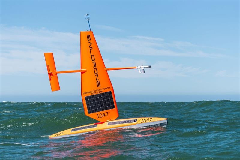

Saildrone's global fleet of unmanned surface vehicles (USVs) are designed to sail the world's oceans in the most extreme conditions collecting atmospheric and oceanographic data above and below the sea surface.
