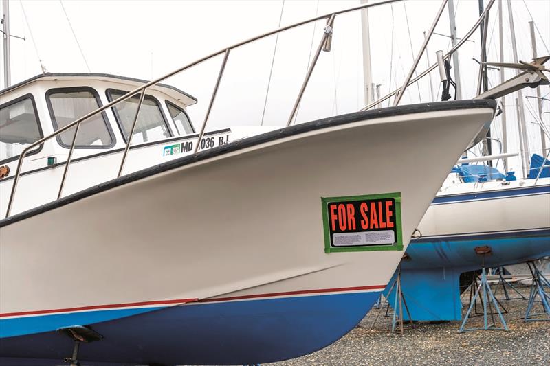

BoatUS offers wise boat buying tips © Stacey Nedrow-Wigmore/BoatUS
