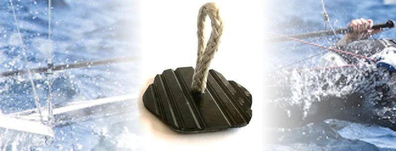

Boats are inherently "curvy" and a limitation of the previous stick-on designs was the requirement to have a perfectly flat surface on which to bond the carbon disk. LOOP Products have got around this by using a clever production technique to produce a flexible, ribbed carbon base which can curve around both internal and external radii to form a strong bond.
The LOOP Products Stick-on padeye is currently available in one size and uses a 4mm Dyneema® with a 40mm loop length. They have a SWL of 150kg.
