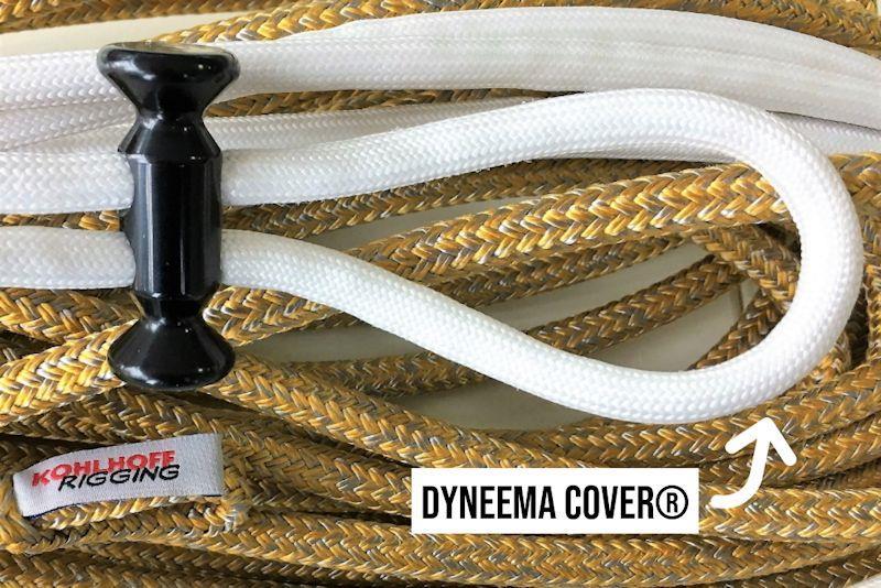

The compromise with stripping is that you are exposing the core of the rope to potential chafe and UV. A performance solution to this can be to actually "re-cover" the stripped core with a thin Dyneema® cover. It might sound crazy to strip one cover off and put another cover on, but this is a very common practice. A pure Dyneema® cover will offer excellent chafe resistance, low friction, and all at a fraction of the weight of the original cover.
For example, at the sail end of a halyard, the original cover can be stripped off completely, down to the halyard exit at the bottom of the mast. A short length (2m) of Dyneema® cover can then be added to protect against chafe at the sheave.
On sheets and guys, having stripped back the original cover to where the line loads on the winch, it is often advisable to re-cover the full exposed length.
