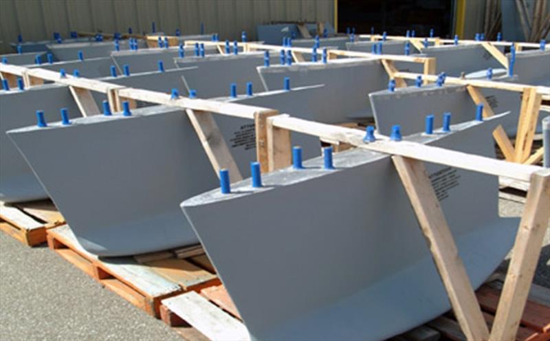

Which type of project are you asking for? This is where our experience assists you. We can assist you through both very complex projects (left KZ7 keel) involving many disciplines, from pattern making, casting, fabrication and CNC machining to far more simple keel castings (4200 lbs keel casting)..

Example 1: Fabricated Fin Material
In terms of a keel fin, be it fabricated or cast, machined partly or completely, this is where our team is likely to have suggestions for the project. Our suggestions are not being critical of the shape or geometry of the keel, they are focused on construction details. We are always looking for new ways to make things like we all are, better, cheaper, and faster. We offer the customer suggestions on things like the material required in a fabricated fin. If for example, they spec a SSAB Weldox grade, we would suggest a grade of ASTM A 514. This material has the same chemical and physical properties, it is less expensive and is available locally.
Example 2: Keel Bolts
We might suggest something as small as a change in keel bolt material to offer a less expensive option if ABS or ISO bolt calculations allow the change. We can make keel bolts or studs and hex and jam nuts out of any material that is needed, from 17-4Ph to 2205 Duplex to NAB. But some smaller projects can have the cost impacted by making custom machined keel bolts and hex nuts rather than a readily available option, 316 SS or A4-70.
