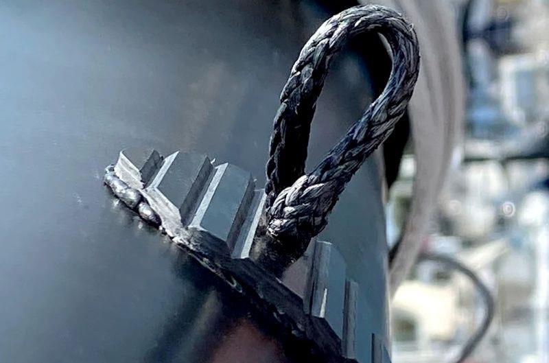

LOOP Flexi Stick-on
This is where the Flexi Stick-on comes into its own. The ingredients of this patent pending technology will be familiar to most e.g. carbon fibre and Dyneema®. However, what makes it unique is the way the disk has been designed to flex /articulate, whilst maintaining a reliable bond between the base and the Dyneema® loop, to achieve a safe working load (SWL) of 75-100kg.
There is currently just one version of the LOOP Flexi Stick-on with a 40mm x 4mm Dyneema® loop on a 53 x 49 mm hexagonal base, with a SWL of 75kg and weighing in at just 9g. However, due to high demand the 4mm version will soon be available in 40, 60 and 100mm loops lengths and a new 6mm diameter line, with a 100kg SWL, is in the pipeline. Work is also under way on developing a 3D Flexi Stick-on which allows flexibility in more than one plane and perfect alignment / bonding on to complex curves.

The 4mm LOOP Flexi Stick-on can be bonded onto a 20mm convex or concave radius (25mm for the new 6mm version), which opens up all sorts of new applications for these lightweight attachment points:

IMPORTANT NOTE: Stick-on padeyes are only has good as the bond between the padeye / surface and the quality of that surface. However, they can be stuck to virtually anything with the correct glue/resin e.g. wood, gelcoat, aluminium spars etc. LOOP Stick-on padeyes are designed to take vertical rather than side load (+/-10) and they should never be used for structural applications.
