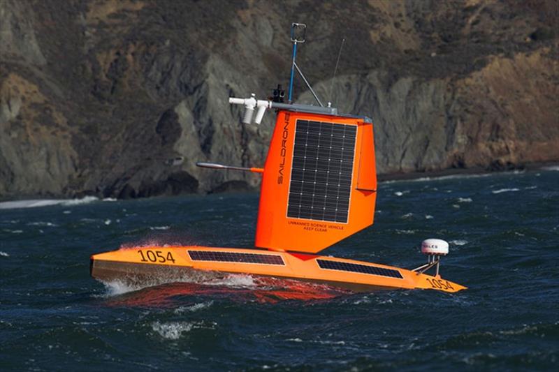

SD 1054 deployed from San Francisco, equipped with a new compact wing designed for extreme high-wind events © Saildrone

What's needed is a way to make direct and simultaneous ocean and atmospheric measurements inside a storm. Earlier this week, Saildrone deployed an uncrewed surface vehicle (USV) equipped with a wing designed to withstand a hurricane.
SD 1054's "storm wing" will be tested for four months in the North Pacific in an area of ocean known for intense winds and high seas. The mission is operated in partnership with the National Oceanic and Atmospheric Administration (NOAA)'s Pacific Marine Environmental Laboratory (PMEL) and Atlantic Oceanographic and Meteorological Laboratory (AOML).

The standard configuration of a Generation 6 saildrone includes a rigid wing that is 5 meters (15 feet) tall. The wing has been optimized for light to moderately heavy wind conditions and has been consistently successful for missions in the Arctic, North Atlantic, Coastal Pacific, and Tropical Pacific regions. However, this tall wing has been damaged in extreme weather conditions like those of the Southern Ocean and the Gulf Stream.
During the 2019 Antarctic Circumnavigation, SD 1020 was equipped with a square wing designed to deal with the huge forces of being rolled and submerged by 15-meter (50-foot) breaking waves. Though the square wing worked well in the Southern Ocean, it does not allow the vehicle to sail upwind, therefore limiting its usefulness in other ocean regions. The compact design of the storm wing is optimized for all points of sail during extreme high-wind events.
