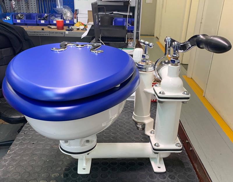

A Blakes toilet is instantly recognisable with its large solid bronze pump cylinders and chrome plated "M" shaped hinge assembly, which rumour and anecdote says comes from supplying Moody's Swanwick boat yard back in the 1920's.

We still use solid bronze castings throughout the assembly, a handmade porcelain toilet bowl that is crafted in Staffordshire and hand-crafted lid and seat assemblies that are manufactured by the same company that manufacture for Her Majesty the Queen. Although we use original castings the very latest machinery is used to give the most accurate and perfect finish that everyone has grown to expect from a Blakes.
A typical renovation consists of disassembling the complete toilet, sand blasting all the castings, re chroming and re powder coating all components, and re assembling with a new perishable spares kit, seat and lid. We are generally able to use all the existing components as they are solid bronze, however in a few cases we have received toilets in that look to have been used as an anchor rather than a toilet and need a few new components to restore them back to new working order.
