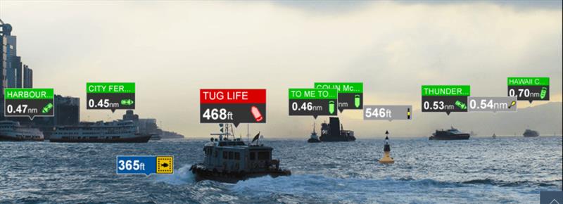

Last year, Raymarine announced its ClearCruise Augmented Reality technology, which uses a camera to overlay high definition video directly on the Raymarine Axiom MFDs. AIS-equipped vessels and charted navigation aids are identified with rich graphics on a live, dynamic video image. It combines all the traditional aids to navigation over a real-world image directly on the MFD.
