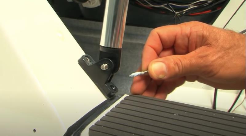

Applying a thin layer of Tef-Gel to screws and other components before installation creates an extra layer of protection, significantly increases the longevity of the metal and at the same time, blocks water ingress which is another major benefit on a sailing yacht.

If you are servicing your rig or other components, add a layer of Tef-Gel to mounting screws, bolts and vulnerable contact surfaces before putting them back together.
This video from Tef-Gel Australia has some useful tips on how and where to apply Tef-Gel to ensure full coverage and protection, if you can excuse the elaborate virtual backdrop!

Tef-Gel is completely non-toxic and not harmful to underwater eco-systems, so it can be used anywhere on your boat. The only rule is to apply it generously to ensure full coverage of the component. If you are applying it to a screw, make sure the whole thread is covered.
