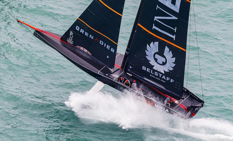

PRADA Cup Final day 2 - Airtime for Britannia in the race 4 pre-start © COR36 / Studio Borlenghi
